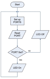

The diagram shows the flow of our first program. The boxes contain actions and the diamond denotes a decision which is made as our program executes. The arrows show how the execution moves from one box to the next.
From this we can see that the program is repeatedly checking the state of the port and switching the light on or off depending on the state of it.
